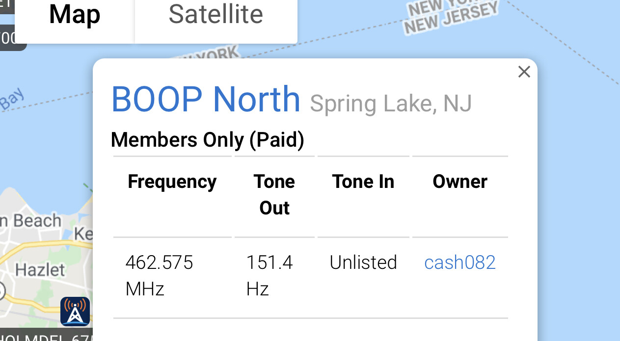

Hello, first thing to look at is that this repeater is not an open repeater and so even if you did program your radio for that repeater, it wouldn’t work.
Look for a repeater that is open and in your area or an ask permission that way you can at least use the repeater.
you can start there and maybe someone with that radio can help you with the radio programming.

Most of the GMRS repeaters located in the US are listed in an online database such as the one on https://mygmrs.com/. The listing includes the PL tone or DPL code as well as its frequency, physical location, owner(s), whether it is public or private and other information. The listing will usually provide the contact information so you can request permission to use it if required. There are clubs and organizations in the US that operate public GMRS repeaters in much the same way as the ham clubs do. many of them operate GMRS nets on a regular basis.

Gmrs repeaters use a 5mhz offset, your transmit frequency is 5 MHz higher than your receive frequency.
There is an offset setting in the menu that must be set to 5mhz and there is also a direction setting that must be set to + (plus)
As previously stated you need a license as well as permission from the owner to access it.
As long as you have a license, I see no problem with accessing it for the purpose of getting hold of the system operator for permission if you can’t find contact information on my gmrs.site.
Try google with the call letters and you should find the name and contact information to reach by mail.
