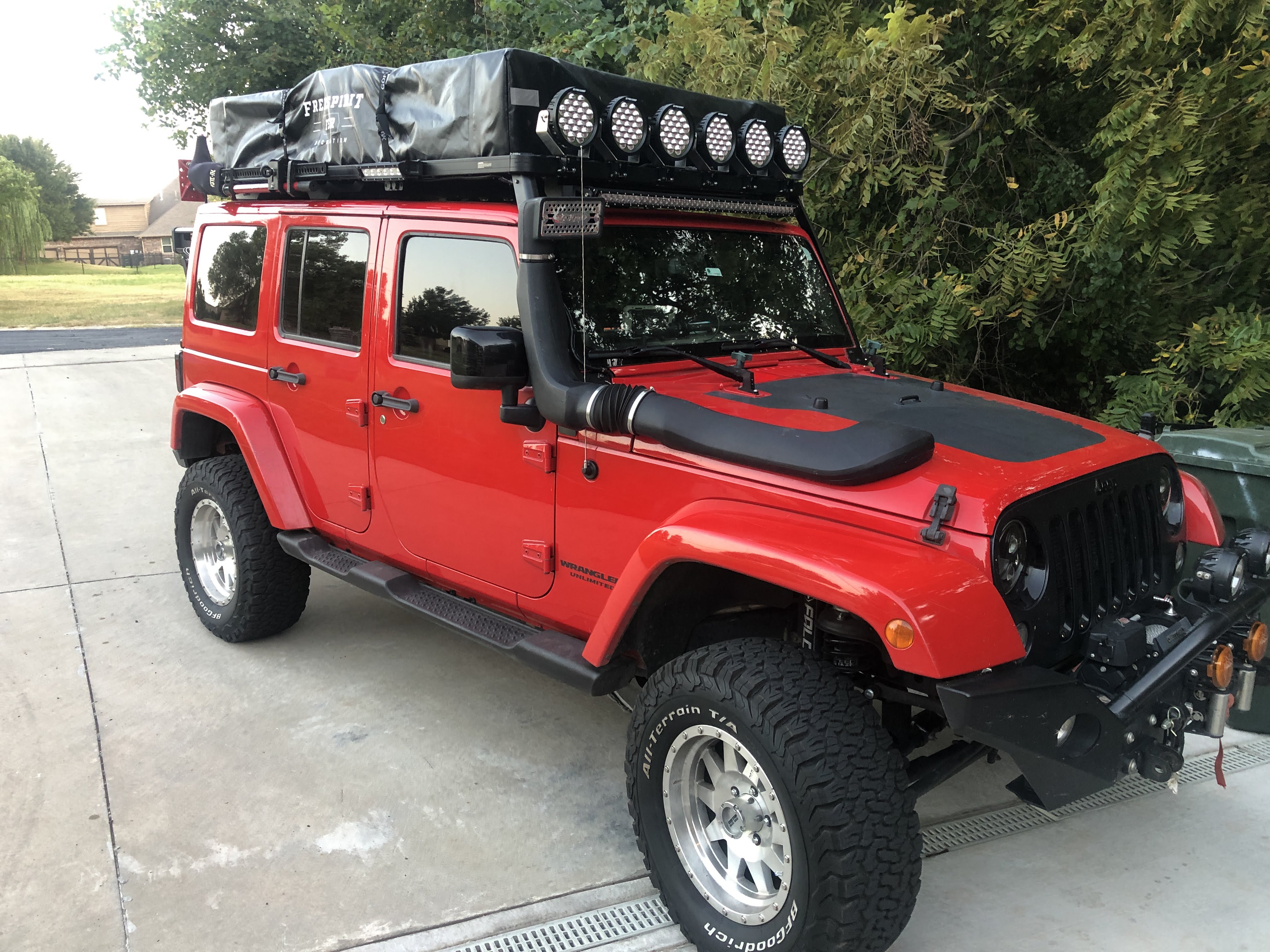

Team, I have recently had a Daystar GMRS Radio installed in my Jeep. The antenna placement and height are poorly designed and I need to replace the antenna. But I’m a newbie here and not sure if there are any specifics on which antenna I can use… Can you guys help me by recommending a replacement antenna that may not be the “whip” style or this short?

Thank you! I meant by not performing, was not in any way towards teh operations, it actually seems to work well but only to about 3-5 miles. However, I meant to refer to the mounting bracket / location. They offer with this radio a bracket and mount that put the antenna right along the A-Pillar. Not only do I THINK this is a bad location, but it rattles against the a-pilllar in any wind… like the highway… hello? …
If that picture reflects how you’d use the jeep, payload wise, I’d just make up a few struts to support and antenna base perched a bit above the roof luggage.
Use a low firing vertical, and where the rules allow, a half-wave or collinear, and your going to be as good as it gets without having a flagpole mast perching the antenna twice or more the height of the vehicle.
Alternative if roof mounting isn’t feasible but antenna sitting and types permitted allow for it, you could use a more body mounted setup and go co-phased vertical pairs or quad phased verticals, but somehow I sense that’ll be way outside of the most LMR rules allow for.
Which is a shame, as UHF radio is well inside the beginnings of where phased arrays actually start becoming compact enough to fit many vehicles and get a good effective setup relatively speaking.
