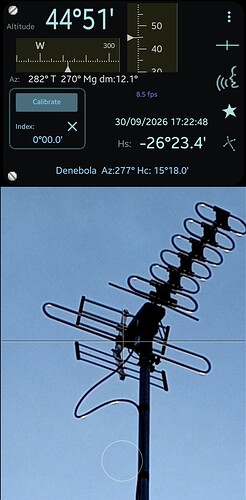

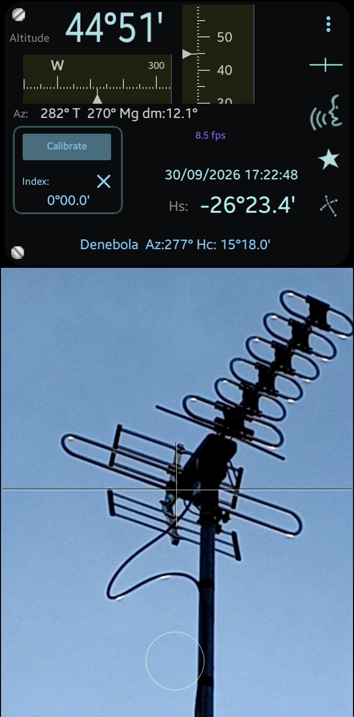

Using a free app at the store call CAM SEXTANT.
  1. Just point to the top antenna and take angle. Then back up 15 to 20 feet { I use my car it us 17 long and everyone thinķ you are only taking photo } (note the distance is need for formula).

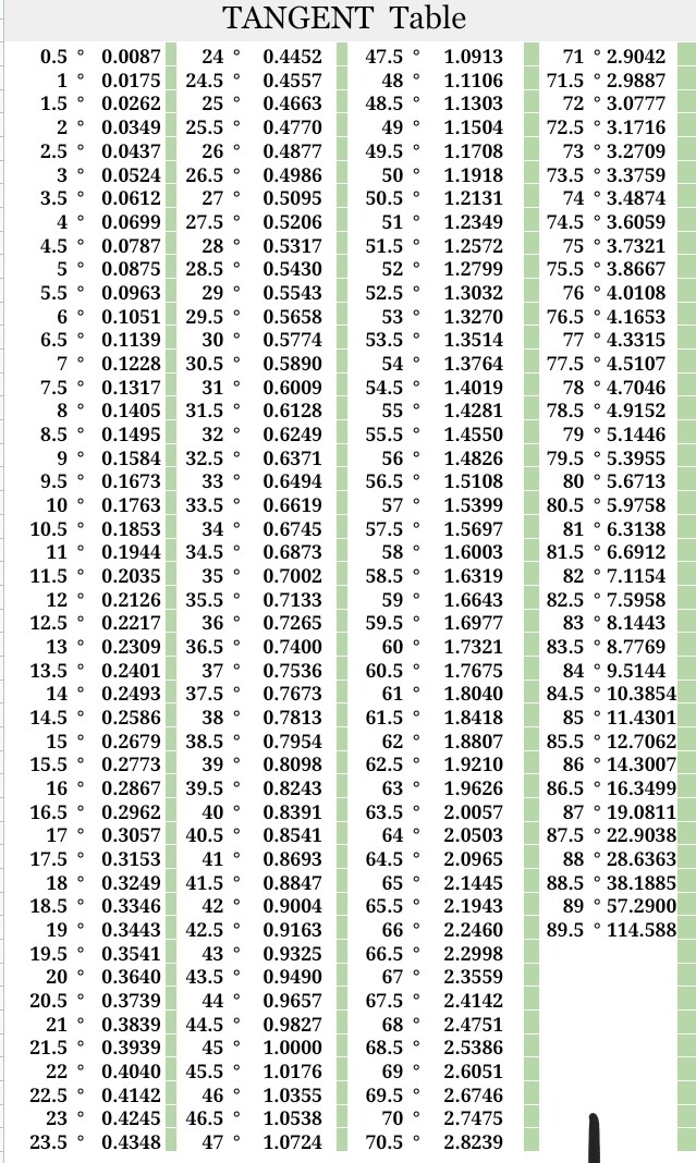

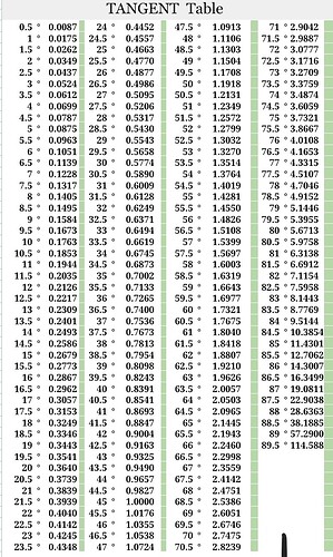

  2. Using the Tangent table get numbers

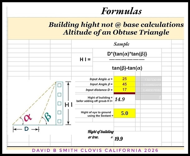

  3. Now you have everything need to find the height two Tangent numbers and length between the two reeds

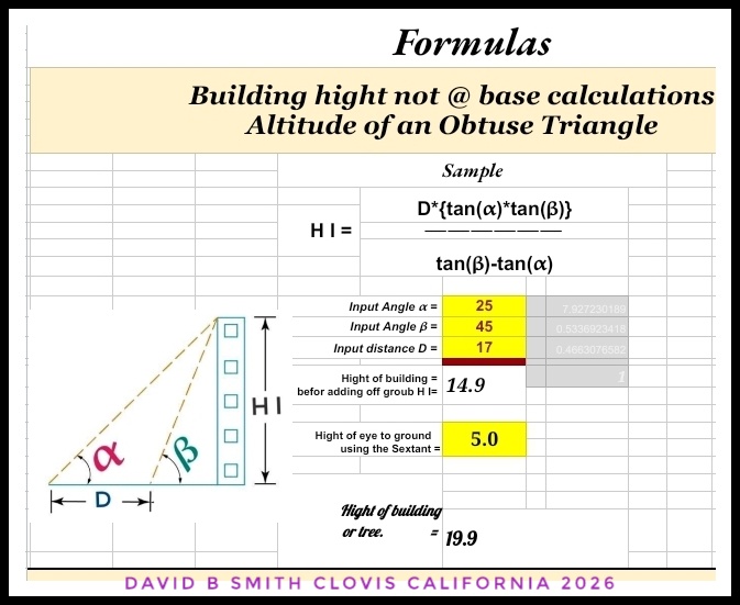

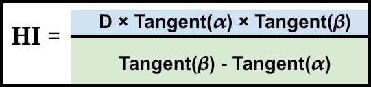

⁜⁜⁜⁜⁜⁜⁜ Using the Formula ⁜⁜⁜⁜⁜⁜⁜
The known information is
D = 17
𝛂 = 25 = Tangent is 0.4662
𝛃) = 45 = Tangent is 1.0000
Cellphone is 5 feet off ground
Top line 17 X 0.4663 X 1.0000 = 7.9271
Bottom line 1.0000 - 0.4663 = 0.5337
Now take 7.9271 ÷ 0.5337 = 14.8531
Now add the height of cellphone off ground we will say 5 feet each person is different
The real height is 14.9 + 5 = 19.9 feet
Accurate is dependent on operation easy is ±2 feet with great care ±0.1 inch
