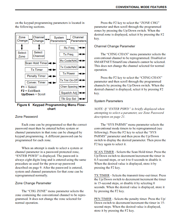

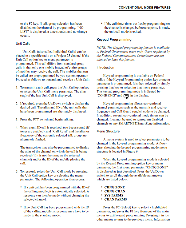

You MIGHT just luck out and discover the radios are “FPP” enabled.
Most of the initial DHS radio gear shared local infrastructure and then handed off their initial hardware (5100’s and 51sl’s) had “Federal Front Panel Programming” functionality, permitting most programming (analog / p25 phase 1) right from the front of the radio, providing it was a model 3 version (display and full keypad).
(the exception – NO TRS ! – it’s far too complex to handle without the programming software – PcConfigure)
