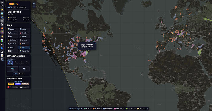

DXLook for VHF Operators - APRS
DXLook is not only about HF. The APRS view can help VHF operators see unusual propagation.
APRS digipeater paths are useful because they are always happening in the background.
When those paths get longer than normal, something may be going on.
For 2m operators, this can be very interesting.
A 100 km path may be normal.
A 500 km path may suggest tropo.
A 1000 km or longer path may suggest a strong opening, depending on the region and season.
The APRS map shows coverage contours based on recent digipeater hop distances.
It is not a QSO map. It is a propagation hint map.
Good uses:
  • Watch for tropo
  • Watch for sporadic E on 2m
  • See regional VHF enhancement
  • Compare current APRS reach with normal conditions
  • Decide when to try calling on 2m SSB, FM, or digital
A few gotchas:
  • APRS data depends on network density.
  • Some regions have many digipeaters.
  • Some have very few
So sparse areas may not show much even when propagation exists.
Also, APRS is not the same as a voice QSO.
But if you see unusual long APRS paths, it may be a good time to turn on the radio and try.
