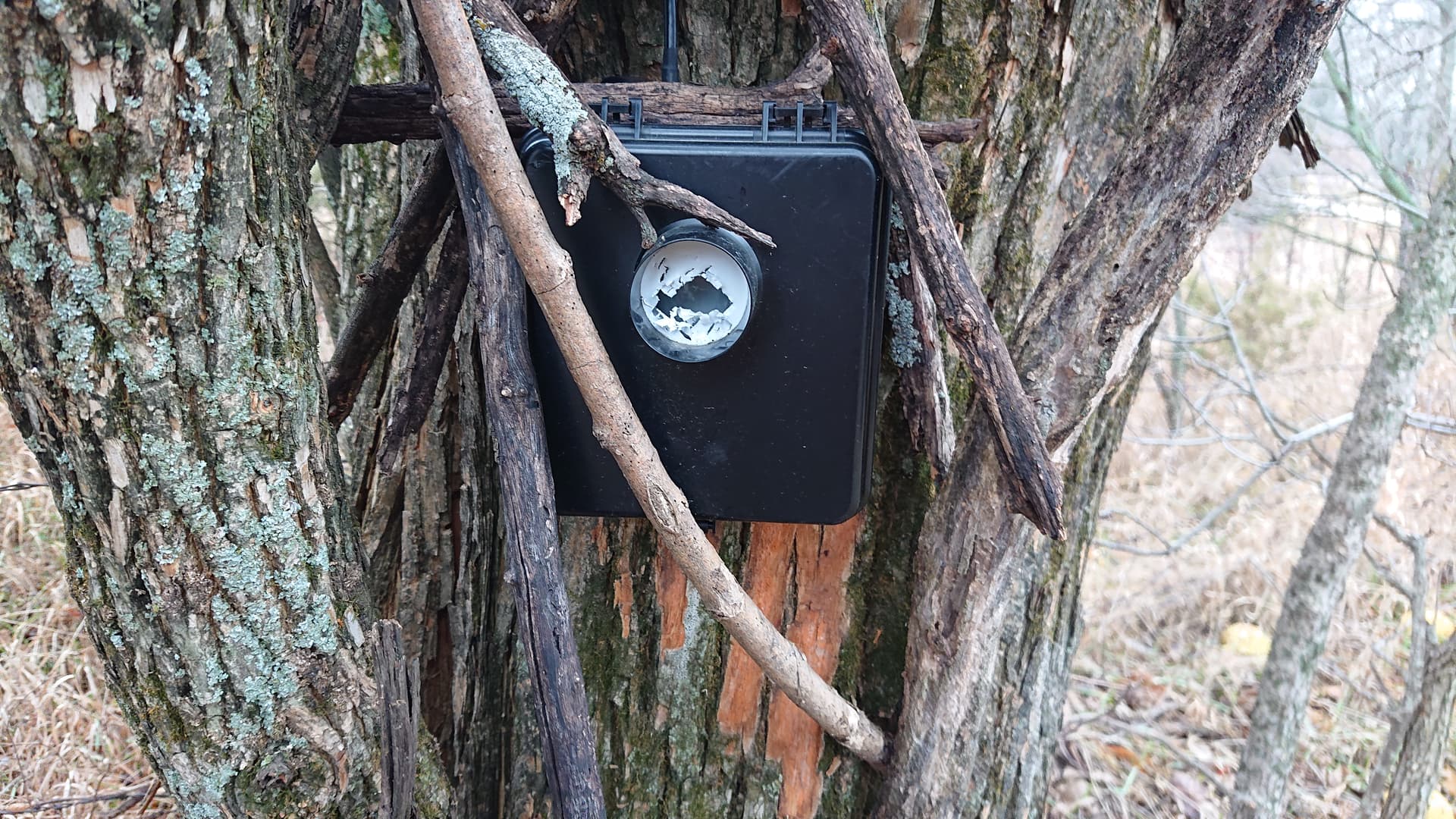

I’ve been using Dakota Alert MURS Alert Transmitter for many years. I’m on my second one, and once again I have an animal (bird probably) attacking the white paper cover in the sensor port.
Questions:
Is it made of special paper?
Can I color it darker to make it less tempting?
Is there a better way to protect the PIR detector?
Many years ago DA sent me some of the paper so I could tape it over the front of the port, but I’m hoping there’s a better fix. Wondering if I’m the only one dealing with this issue.

I have one of these same transmitters from dakota murs, although I don’t use it anymore as it sits out in the tree with dead batteries, but mine came with a wood birdhouse to hide it. That wood birdhouse had a single vertical wire and a single horizontal wire blocking the PIR window hole and I have not once had an issue. Either the wires work or your birds are more determined than mine. Just go with wire to start with, your unit is already waterproof and the manufacturer does that already.
I’ve seen those birdhouses, but I didn’t know about the wire. Thanks for that real world info.
Now I know that at least one wire of some kind of metal will work. It gives me hope. My next step will be to find or manufacture a properly sized ring so I can put my paper cover deeper inside the tube.
I even tried putting a handful of mothballs inside the unit. Didn’t bother them at all.
I can run down the road and take a picture of mine (if its still there). I believe the wires are thin, but I don’t see thick ones being an issue. I can even throw some batteries in it and staple more wires to the front and see what happens… Im kinda bored out here in the woods anyhow.
