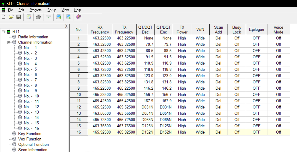

I just recently acquired the Retevis RT1
This is the default channel/frequency range:
The manufacturer states this unit can be programmed up to the 520.00000MHz range.
The FCC’s guidelines for GMRS range is only within the 462 and 467 MHz frequency range
The manufacturer also claims to TX at 10W.
I’m going on a cruise and wanted to program my units to the best channel/frequencies possible that will take advantage of the 10w proclaimed by the manufacturer .
What is recommended.
Please assist.
Thank you
To do what? Be aware that some cruise lines have a ban on radios so you will have to smuggle the radio on board, and one radio wont really give you any people to talk to as GMRS is American and cruise ships rarely stay in America, so on a ship, the use of radio is totally under the captain or masters control. The boat wont be American, even if it appears to be, it will be registered in some foreign country. Radio hams occasionally get granted permission to use a radio on board with lots of paperwork. Random passengers walking along with a radio will draw the security folk. Hiding them can be even worse. Expect it to be spotted during x-ray on most cruise lines. Most radios on board will be a mix of marine analogue VHF and digital, both UHF and VHF.
What are you hop8ng to do with it?

Understand that Chinese manufacturers generally program these radios with random default frequencies and expect end users will program them properly. Using any of these frequencies mean you will possibly interfere with licenced users, and can possibly even interfere with critical public safety transmissions.
Personally, I would check with the cruise ship line for their policy on GMRS/FRS radios, and if allowed, I would program them to the FRS channels. Just be careful not to use them inside territorial waters because these radios are not certified in the U.S. or Canada for either GMRS or FRS channels. But outside territorial waters - which is where you will get the most use out of them - the rules don’t apply. But please delete those default frequencies and check with the cruise line.
Lots of passengers use FRS, GMRS and Motorola FHSS radios; but some cruise lines will only allow radios that are bought or rented on board. If they do allow personal radios, just reprogram them and avoid use in illegal territorial waters, and enjoy the radios.
