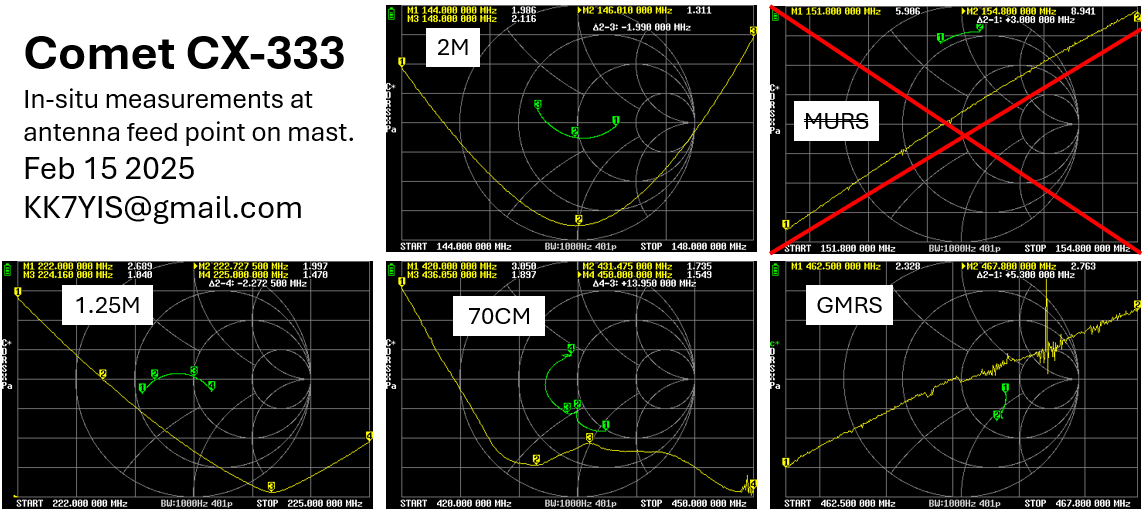

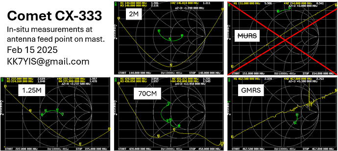

This is a good antenna, especially if you want the 1.26m (220) band. It presents some SWR challenges in the bottom 1/4 of the 70cm band. GMRS looked bad on a test stand because it needs a counterpoise. On a mast it looks quite workable. Probably won’t work on MURS at all.
