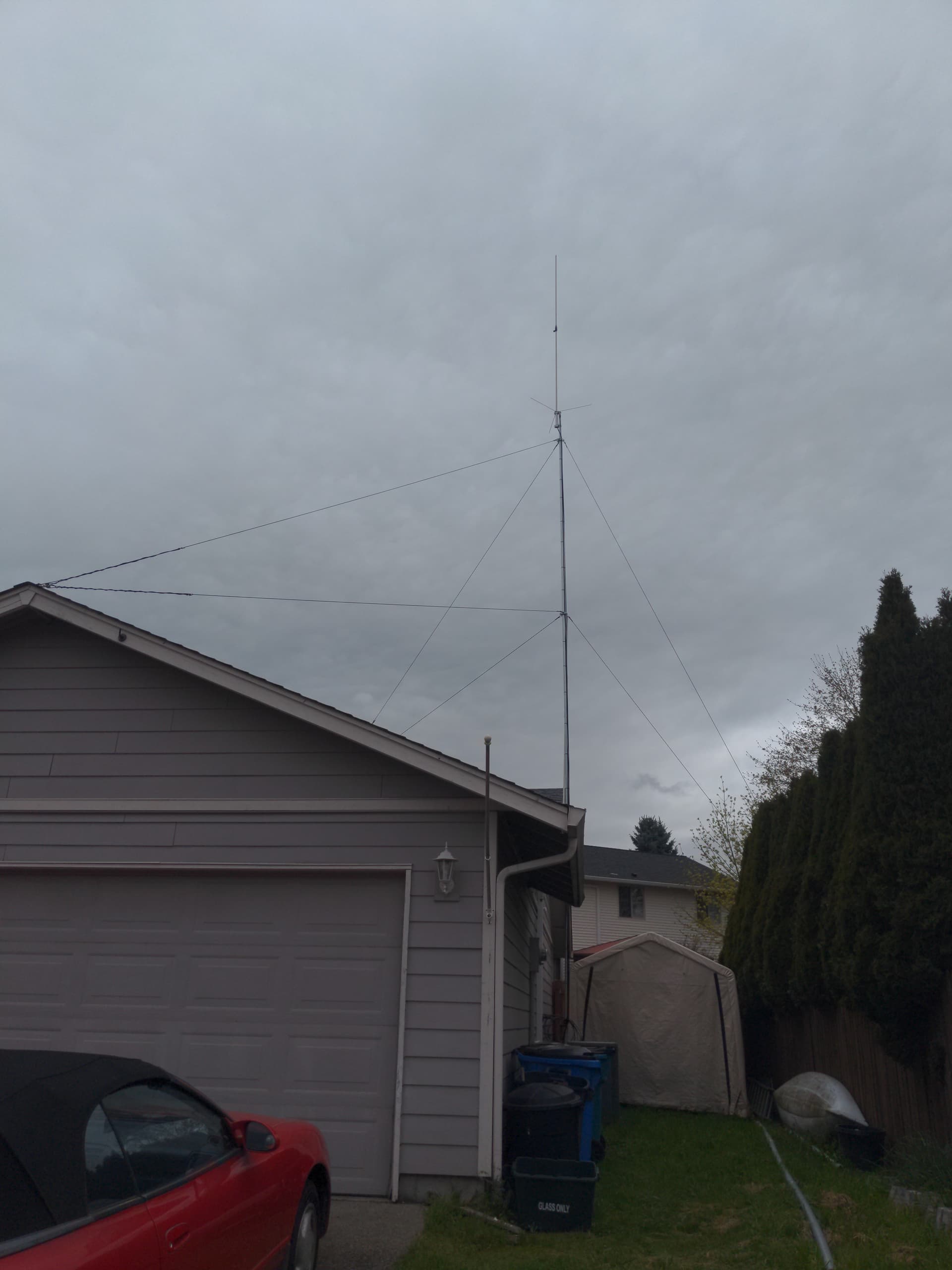

I have the Comet CA-712EFC antenna. It works great. I have it on a chain-link fence top-rail mast of 30 feet. I guyed it using 3 strands of 3/16" poly-dacron rope at the 30 ft and the 20 ft levels (used cable thimbles with poachers knot, quick links, and some rope tensioners with pulleys at the bottom). I have a 40 ft LM-400 feedline feeding the radio.
With your setup, I would imagine you’re getting some great GMRS contacts! A 9db gain antenna is a rarity. I checked it out on the web and it’s out of stock everywhere! I’m guessing it’s manufactured in China. That’s a shame.
