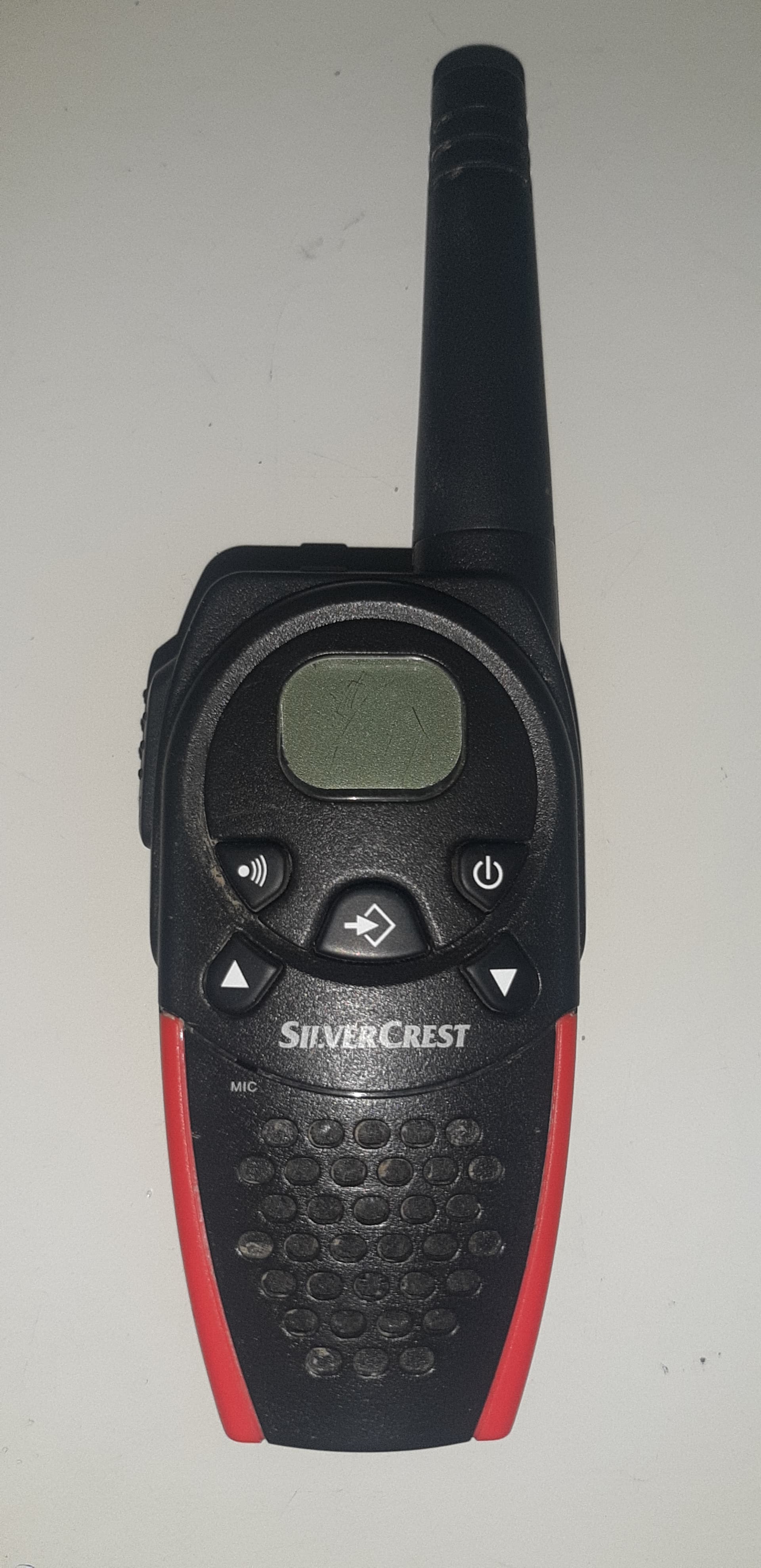

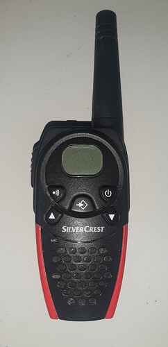

This is my radio. Pmr 446mhz. I bought it at a car boot sale once for small money. It isnt great. The audio Rx and Tx is horrible and the range is useless. You can barely understand someone talking.
