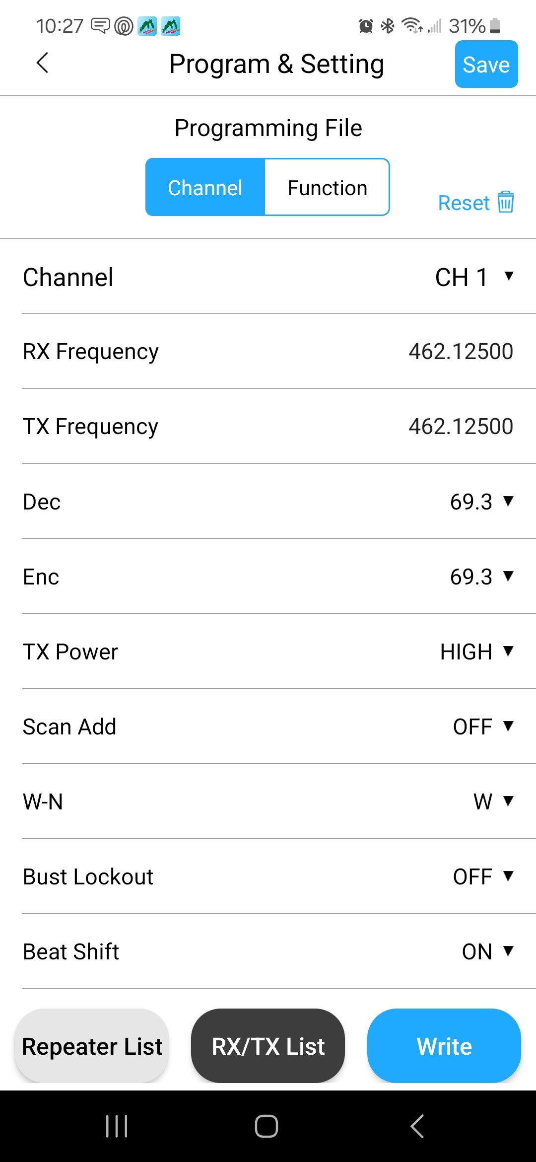

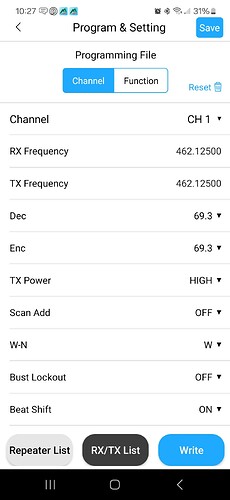

Ok so i have the uv5r and the bf888s both and they do work together if you have them setup right i had a hard time doing this fro. The radio itself but they sell a Bluetooth programmer and you can read the bf888s and write that to your uv5r

That is ch 1 on the bf888s if you look at your radio i would say its not setup like this
