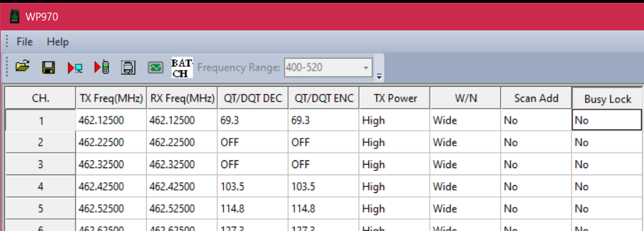

I have a Baofeng BF9700, the one similar to BF888s but with bigger case with IP67 rating. I’ve been trying to connect my TYT UV8000D to its channel 1 that I programmed with CTCSS tone(69.3Hz in this case).
It does light up green, so I know it is hitting the radio, yet I can’t hear any audio received unless I press the monitor button on the side. This is true vice versa.
I do know that my TYT is working fine because I can hit our local repeater that has CTCSS tone on it.
Anyone here who knows how to fix this.
I am using the WP970 programming software for the BF9700.
Are you sure the tones are the same on RX and TX? Can you do a CTCSS scan? If you take the tone off the receiving radio can you hear the transmitting radio?
Sorry, my bad, just a typographic error. It should be 69.3Hz on my post. I doubled check both rx and tx ctcss of my radios, they are the same settings. They won’t just connect. If I only press the monitor button of the receiving radio will I be able to hear them connect.
As far as I know, my ht can’t do ctcss scan. but I tried using all the ctcss on my tyt yet it wont work. They will only connect if ctcss is OFF on both radios, or if you press the monitor button on the receiving end.
First thing is to determine which is the problem. Wrong tone, or not enough. It’s worth trying the narrow setting as this changes the level of the tones between radios with different bandwidths. If you are uncertain if the radio is actually sending a tone, pick a higher one - 250.3 is very obvious on a strong signal with no noise, you can usually hear it. It’s unusual for tones to be wrong, so probably just a mismatch in bandwidth, so the tone is a touch too low, and doesn’t trigger the squelch opening.

Yes, I am a General Class License Holder. Got it last month. I got the Baofeng as a gift for passing, yet the one who gave it wasn’t aware of the details that the frequencies weren’t type certified. I just got bought the programming cable to change the frequencies and band setup in order for me to get it right. Yet before I even able to change it, my two radios won’t connect.
