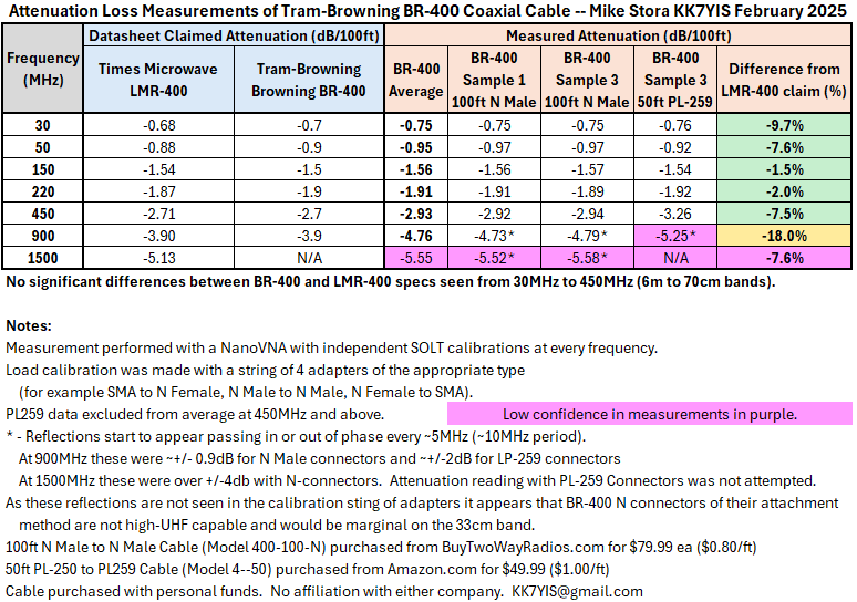

This is excellent cable and appears to be a faithful copy of Times Microwave LMR-400 but the supplied N Male connectors appear to be marginal at some point between the 70 and 33cm bands. Of course, PL-259 connectors are not good above about 300MHz in general but we are stuck with them
This will be my go-to base station cable for HF and VHF. I would not hesitate to use this cable on 70cm or even GRMS.
I would strongly consider using this cable at even higher frequencies but with better connectors.
