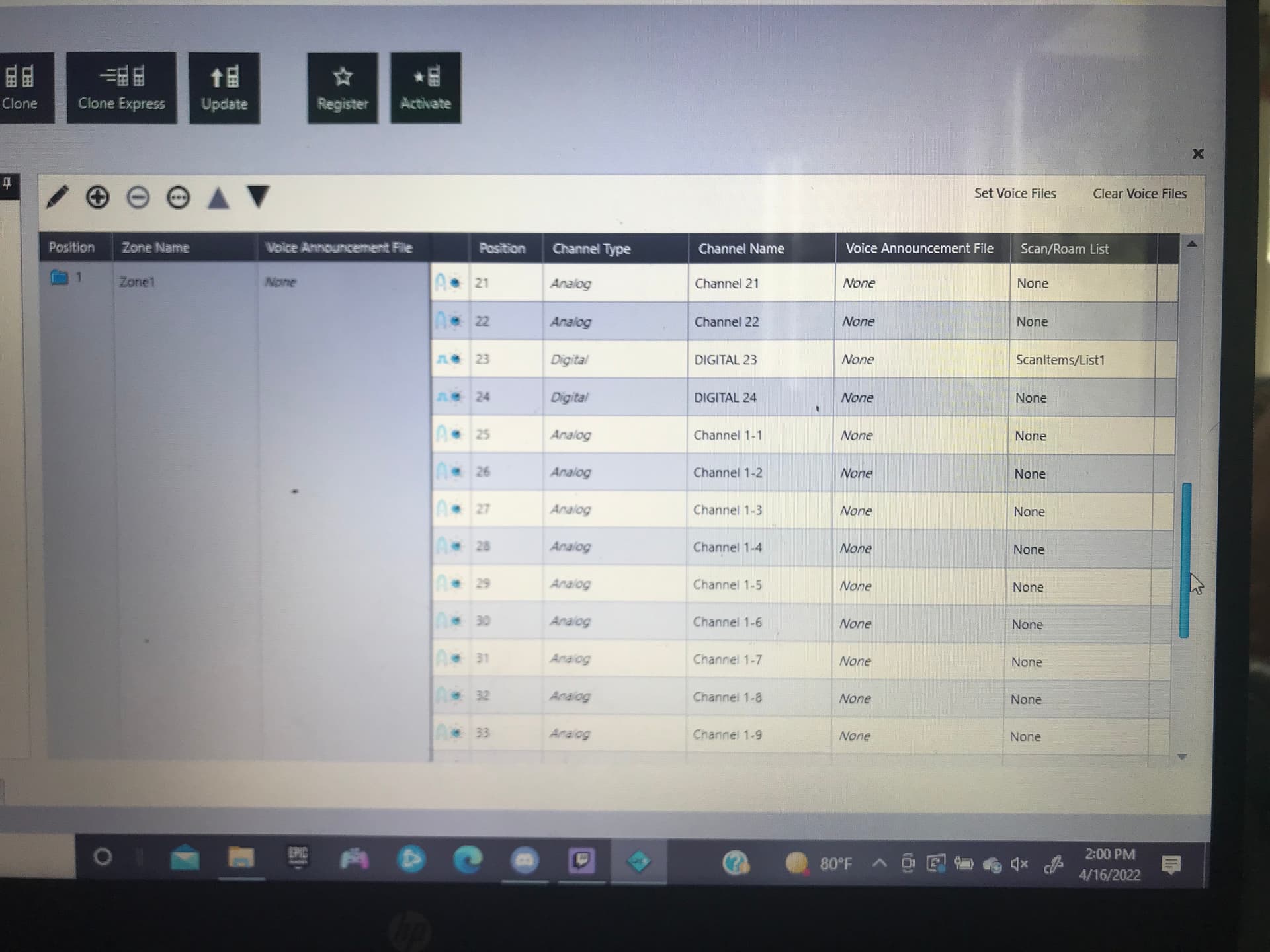

Im programming privacy lines on the analog channels on my XPR7550E radios so i can cominicate with the workers using talkabouts and ctcss codes. Ive made a channel for each channel/pl such as 1-1,1-2,1-3 or 11-1,11-6 and so on and such… for each channel, only the first pl such as 1-1, 2-1, 3-1 and so on function… all the other pl channels theres no sound on either radio but both show to be receiving and transmitting. I make a new channel for each pl and use the same tx and rx frequency for that channel, and enter the different ctcss for each pl.

I don’t quite understand your numbering system. Can we see a screenshot? That would help no end.
I figured it out. I was using the wrong chart. The talk about radios skip the number 2 PL code on most lists. Swear i spent hours on this. Oh well its all good now.
