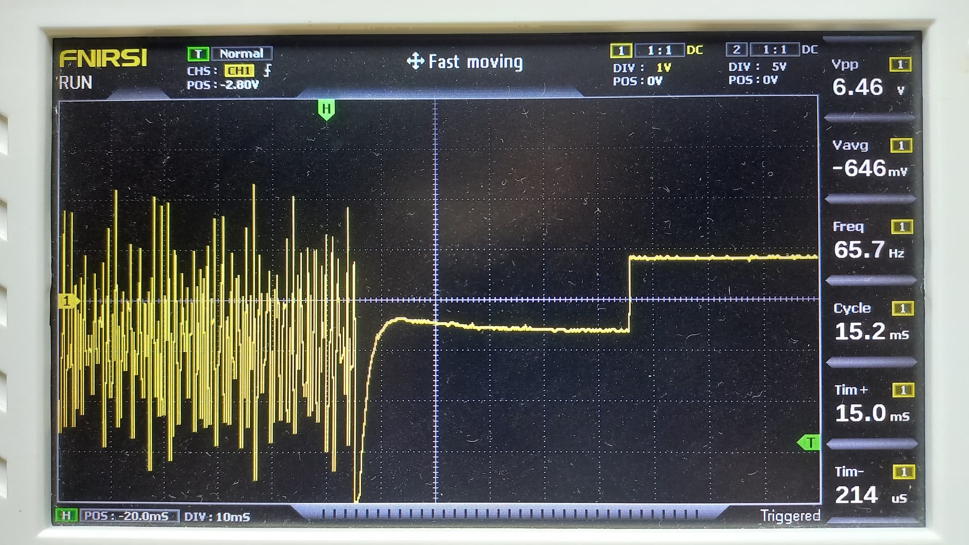

Yes, thank you for writing about the squelch level controls; I know that’s what the side buttons do. But I was trying to solve a different issue. Let me explain.
When I bought this radio, I immediately noticed that the squelch level controls wasn’t working properly. When it triggers after receiving a signal, it closes with a click. It’s jarring, even if you listen for 10 minutes. I didn’t expect such a poor level of implementation in a far from complex issue of squelch level controls. And they market this radio as a professional, expensive one…
I checked the signal with an oscilloscope—that’s exactly it: after the signal level drops, there’s a positive pulse, and that’s what makes the clicking sound. Even the cheap $30 Quansheng UV-K5 (99), which has aircraft radio reception, doesn’t have this;
the squelch level controls closes smoothly. All of this can be easily fixed with software. I tried writing to them, sending them videos, but they simply ignore me. They probably don’t want to improve their products.
Another problem: in professional aviation radios with amplitude modulation, the squelch opening and closing levels differ; the difference should be 1–1.5 dB. That is, if the squelch opens at, say, 1 µV, it should close at 0.8 µV.
There needs to be some kind of “loop” to prevent the radio from “buzzing” on the squelch at weak signals. This isn’t implemented either.

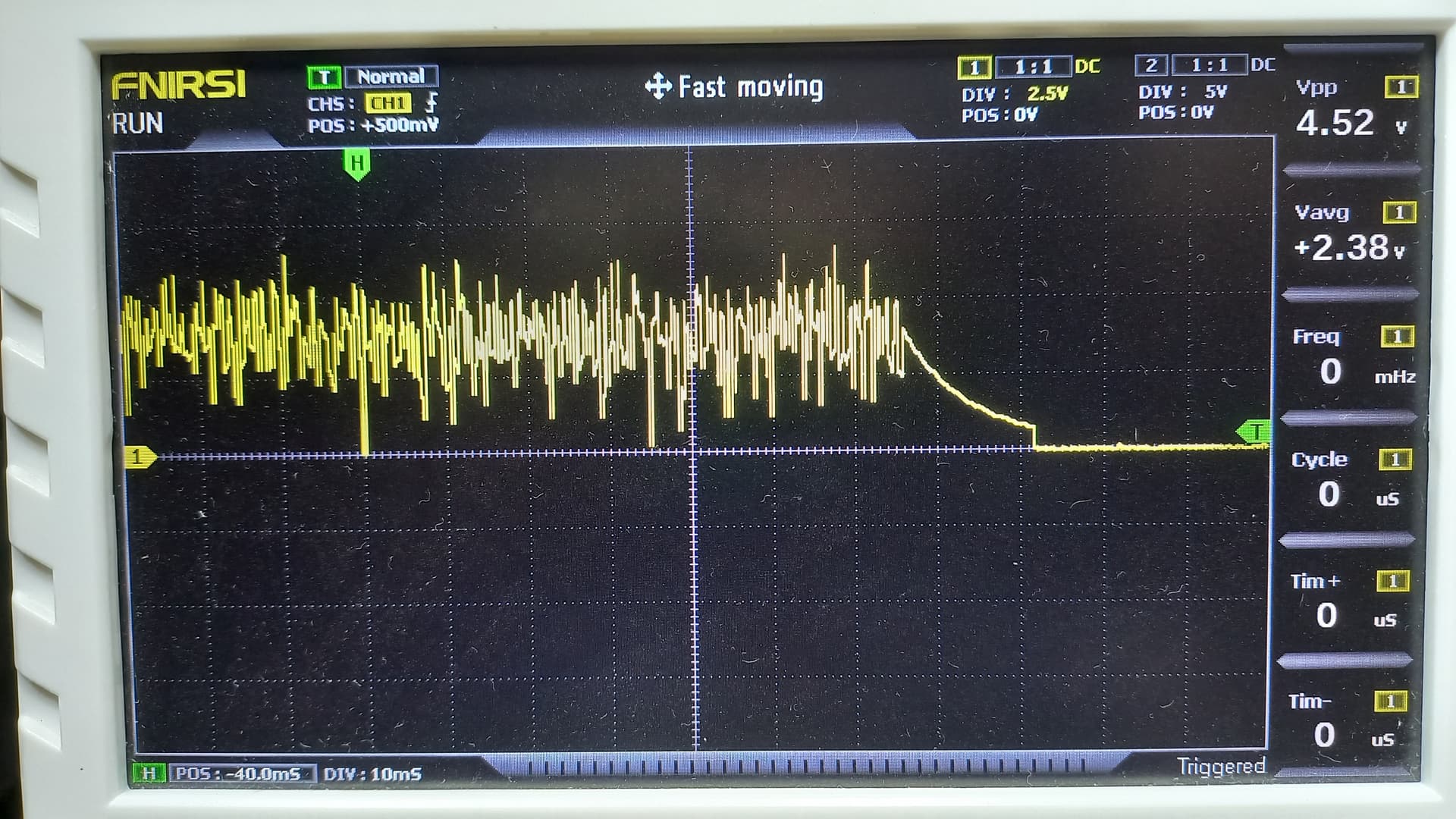

P.S.
Here’s how the squelch level control on the Quansheng UV-K5 works correctly.
