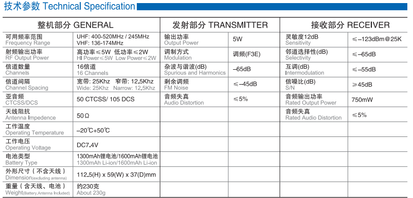

In warehouse,use with my workmates
This is a technical specification picture my Chinese supplier sent me.
should i care about this?
